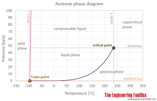

The phase diagram of acetone is shown below the table.

Acetone is a liquid at standard conditions. However, at low temperature and/or very high pressures it becomes a solid.
The phase diagram for acetone shows the phase behavior with changes in temperature and pressure. The curve between the critical point and the triple point shows the acetone boiling point with changes in pressure. It also shows the saturation pressure with changes in temperature.
