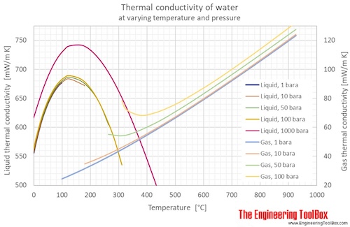

Thermal Conductivity of Water: Temperature and Pressure Data
Figures and tables showing thermal conductivity of water (liquid and gas phase) with varying temperature and pressure, SI and Imperial units.
Thermal conductivity is a material property that describes ability to conduct heat. Thermal conductivity can be defined as
The thermal conductivity of water depends on temperature and pressure as shown in the figures and tables below:

Thermal conductivity of water at given temperatures (°C) and 1 bara:
| State of water | Temperature | Thermal conductivity | ||
| (°C) | (mW/m K) | (kcal(IT)/(h m K)) | (Btu(IT)/(h ft °F)) | |
| Liquid | 0.01 | 555.75 | 0.4779 | 0.3211 |
| 10 | 578.64 | 0.4975 | 0.3343 | |
| 20 | 598.03 | 0.5142 | 0.3455 | |
| 30 | 614.50 | 0.5284 | 0.3551 | |
| 40 | 628.56 | 0.5405 | 0.3632 | |
| 50 | 640.60 | 0.5508 | 0.3701 | |
| 60 | 650.91 | 0.5597 | 0.3761 | |
| 70 | 659.69 | 0.5672 | 0.3812 | |
| 80 | 667.02 | 0.5735 | 0.3854 | |
| 90 | 672.88 | 0.5786 | 0.3888 | |
| 99.6 | 677.03 | 0.5821 | 0.3912 | |
| Gas | 100 | 24.57 | 0.0211 | 0.0142 |
| 125 | 26.66 | 0.0229 | 0.0154 | |
| 150 | 28.83 | 0.0248 | 0.0167 | |
| 175 | 31.09 | 0.0267 | 0.0180 | |
| 200 | 33.43 | 0.0287 | 0.0193 | |
| 225 | 35.85 | 0.0308 | 0.0207 | |
| 250 | 38.34 | 0.0330 | 0.0222 | |
| 275 | 40.91 | 0.0352 | 0.0236 | |
| 300 | 43.53 | 0.0374 | 0.0252 | |
| 350 | 48.98 | 0.0421 | 0.0283 | |
| 400 | 54.65 | 0.0470 | 0.0316 | |
| 450 | 60.52 | 0.0520 | 0.0350 | |
| 500 | 66.58 | 0.0573 | 0.0385 | |
| 550 | 72.81 | 0.0626 | 0.0421 | |
| 600 | 79.17 | 0.0681 | 0.0457 | |
| 700 | 92.28 | 0.0794 | 0.0533 | |
| 800 | 105.81 | 0.0910 | 0.0611 | |
| 900 | 119.67 | 0.1029 | 0.0691 | |
