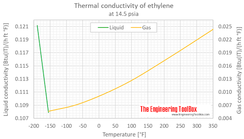

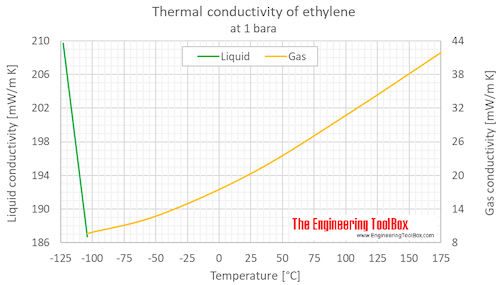

Thermal conductivity of ethylene as function of temperature, given as °C and °F, at atmospheric pressure:
Ethylene thermal conductivity 1 bara C
Ethylene thermal conductivity 1 bara F

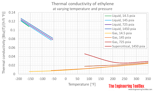

Thermal conductivity of ethylene as function of temperature, given as °C and °F, and pressure:
Ethylene thermal conductivity pressure C
Ethylene thermal conductivity pressure F

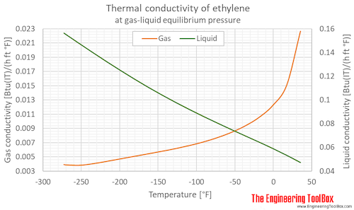

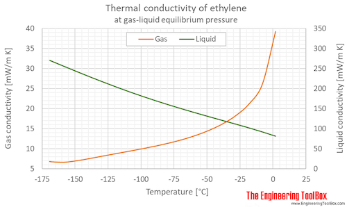

Thermal conductivity of ethylene at gas-liquid equilibrium pressure and varying temperature, given as °C and °F:
Ethylene thermal conductivity equilibrium C
Ethylene thermal conductivity equilibrium F
