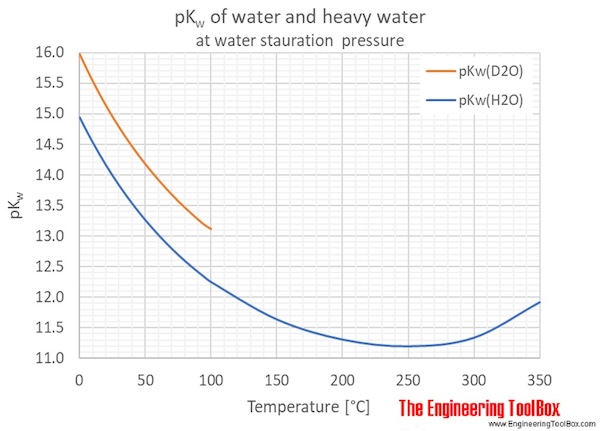

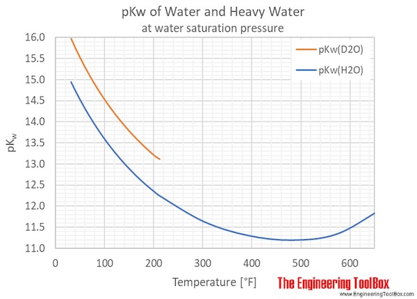

Often, a general value of 1.00×10¯14 is used. However, pKw varies with the temperature as shown in the figures and tables below.
From the chemical equation (1) above, it can be seen that H3 O+and OH¯ concentrations are in the molar ratio of one-to-one. This means that (H3 O+) = (OH¯). Therefore the values of (H3 O+) and (OH¯) can be determined by taking the square root of Kw .
Heavy water, D2O, self-ionizes less than normal water, which gives larger pKw values for D2O compared to H2O.

pKw_C
pKw_F
