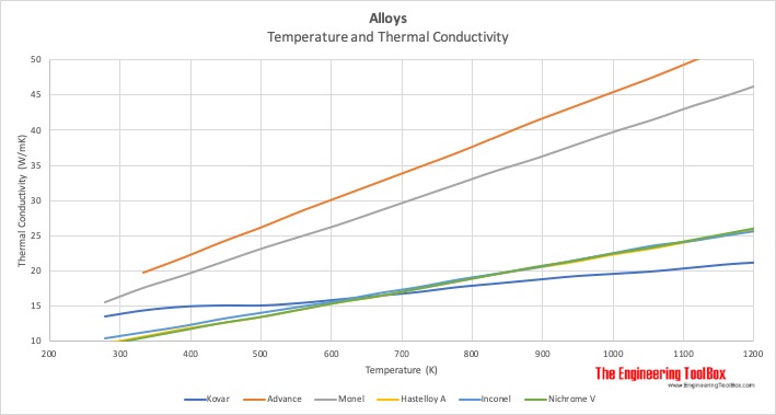

Alloys - Temperature and Thermal Conductivity
Temperature and thermal conductivity for
  • Hastelloy A
  • Inconel
  • Nichrome V
  • Kovar
  • Advance
  • Monel
alloys:
Alloys - temperature and thermal conductivity - Hastelloy A, Inconel, Nichrome V, Kovar, Advance, Monel
