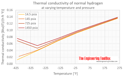

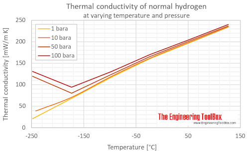

Thermal conductivity of normal hydrogen as function of temperature and pressure, given as °C and °F:
Hydrogen normal thermal conductivity pressure C

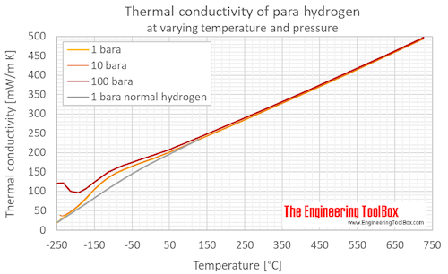

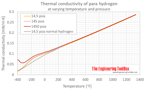

Hydrogen normal thermal conductivity pressure F Thermal conductivity of para hydrogen as function of temperature and pressure, given as °C and °F:
Hydrogen para thermal conductivity pressure C
Hydrogen para thermal conductivity pressure F

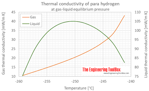

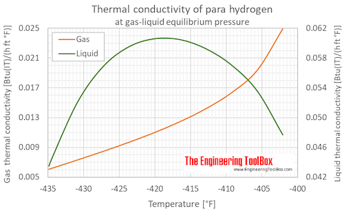

Thermal conductivity of para hydrogen at gas-liquid equilibrium pressure and varying temperature, given as °C and °F:
Hydrogen para thermal conductivity equlibrium C
Hydrogen para thermal conductivity equlibrium F
