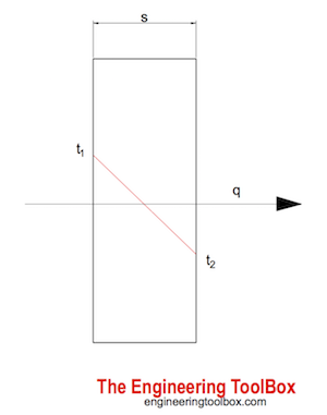

Example - Conductive Heat Transfer through an Aluminum Pot versus a Stainless Steel Pot
Convective heat transfer
The conductive heat transfer through a pot wall can be calculated as
q = (k / s) A dT                                                (1)
or alternatively
q / A = (k / s) dT
q = heat transfer (W, Btu/h)
A = surface area (m2, ft2)
q / A = heat transfer per unit area (W/m2, Btu/(h ft2))
k = thermal conductivity  (W/mK, Btu/(hr ft °F))
dT = t1 - t2= temperature difference ( oC, oF)
s = wall thickness (m, ft)
Conductive Heat Transfer Calculator
Note! - that the overall heat transfer through a surface is determined by the " overall heat transfer coefficient " - which in addition to conductive heat transfer - depends on
Conductive Heat Transfer through an Aluminum Pot Wall with thickness 2 mm - temperature difference 80 oC
Thermal conductivity for aluminum is 215 W/(m K) (from the table above). Conductive heat transfer per unit area can be calculated as
q / A = [(215 W/(m K)) / (2 10-3 m)] (80 oC)
= 86 00000 (W/m2)
= 8600 (kW/m2)
Conductive Heat Transfer through a Stainless Steel Pot Wall with thickness 2 mm - temperature difference 80 oC
Thermal conductivity for stainless steel is 17 W/(m K) (from the table above). Conductive heat transfer per unit area can be calculated as
q / A = [(17 W/(m K)) / (2 10-3 m)] (80 oC)
= 680000 (W/m2)
= 680 (kW/m2)
