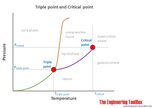

Water vs. Steam - Critical and Triple Points
Critical point is where vapor and liquid are indistinguishable and triple point is where ice, water and vapor coexist in thermodynamic equilibrium.
At the critical point there is no change of state when pressure is increased or if heat is added. At the critical point water and steam can't be distinguished and there is no point referring to water or steam.
The critical point of water is achieved at
  • Water vapor pressure of 217.75 atm = 220.64 bar = 22.064 MPa = 3200.1 psi
  • Temperature of 647.096 K = 373.946 °C = 705.103 °F
  • Critical point density: 0.322 g/cm3 = 0.6248 slug/ft3 = 20.102 lbm/ft3
For states above the critical point the steam is supercritical . Supercritical is not the same as superheated - which is saturated steam at lower pressures and temperatures heated above the saturation temperature.
The triple point of water is at
  • Water vapor pressure of 0.00604 atm = 6.12 mbar = 611.657 Pa = 0.08871 psi
  • Temperature 273.16 K = 0.01 °C = 32.02 °F
  • Triple point density (liquid): 0.99979 g/cm3 = 1.93991 slug/ft3 = 62.4148 lbm/ft3
