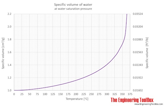

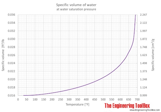

The specific volume of water depends on temperature as shown below:
