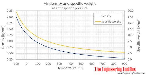

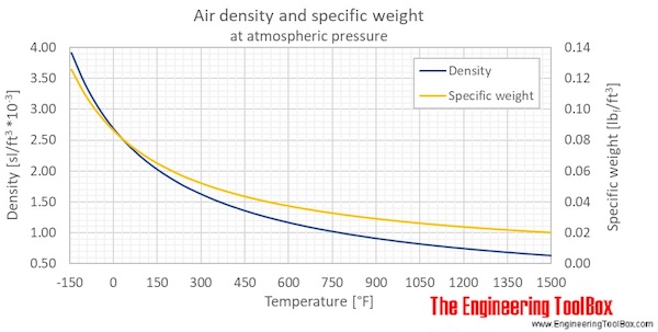

Air density and specific weight at atmospheric pressure:

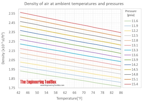

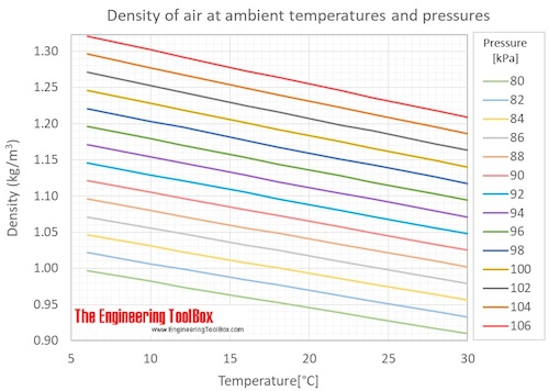

Air density at ambient temperature and pressure:

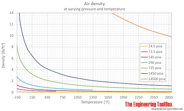

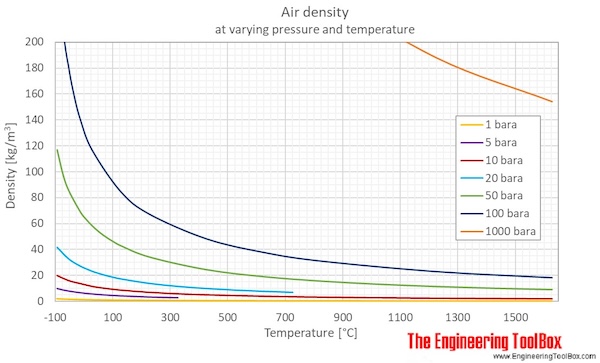

Air density at varying pressure and temperature:

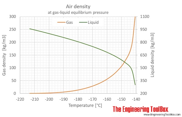

Air density at gas-liquid equilibrium pressure:

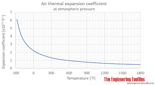

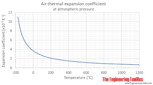

Air thermal expansion coefficient at atmospheric pressure:
Density, specific weight and thermal expansion coefficient of air at 1 atmosphere pressure, at temperatures given as °F:
For full table specific weight and thermal expansion coefficient - rotate the screen!
