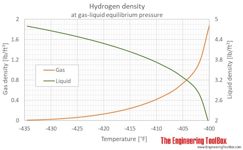

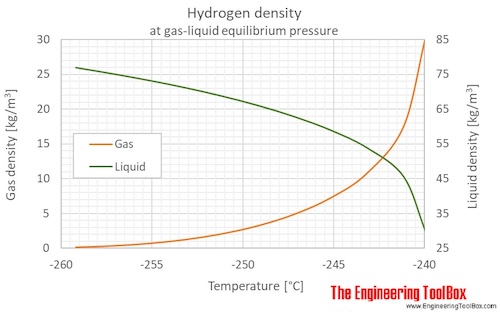

Density and specific weight of hydrogen at given temperatures and pressures:
For full table with Denity and Specific Weight - rotate the screen!
| [K] | [°C] | [°F] | [MPa] | [bara] | [psia] | [mol/dm3] | [g/l], [kg/m3] | [lbm /ft3] | [sl/ft3 *10-3] | [N/m3] | [lbf /ft3] | |
Liquid at equilibrium pressure |
13.96 | -259.2 | -434.5 | 0.00770 | 0.0770 | 1.12 | 38.15 | 76.91 | 4.801 | 149.2 | 754.2 | 4.801 |
| 14 | -259 | -434 | 0.00789 | 0.0789 | 1.14 | 38.13 | 76.87 | 4.799 | 149.1 | 753.8 | 4.799 | |
| 16 | -257 | -431 | 0.0215 | 0.215 | 3.12 | 37.26 | 75.12 | 4.689 | 145.8 | 736.7 | 4.689 | |
| 18 | -255 | -427 | 0.0481 | 0.481 | 6.97 | 36.32 | 73.22 | 4.571 | 142.1 | 718.1 | 4.571 | |
| 20 | -253 | -424 | 0.0932 | 0.932 | 13.5 | 35.27 | 71.11 | 4.439 | 138.0 | 697.4 | 4.439 | |
| 22 | -251 | -420 | 0.163 | 1.63 | 23.7 | 34.09 | 68.73 | 4.291 | 133.4 | 674.0 | 4.291 | |
| 24 | -249 | -416 | 0.264 | 2.64 | 38.3 | 32.74 | 66.00 | 4.120 | 128.1 | 647.2 | 4.120 | |
| 26 | -247 | -413 | 0.403 | 4.03 | 58.4 | 31.15 | 62.80 | 3.921 | 121.9 | 615.9 | 3.921 | |
| 28 | -245 | -409 | 0.585 | 5.85 | 84.9 | 29.23 | 58.92 | 3.678 | 114.3 | 577.8 | 3.678 | |
| 30 | -243 | -406 | 0.850 | 8.50 | 123 | 26.71 | 53.84 | 3.361 | 104.5 | 528.0 | 3.361 | |
| 32 | -241 | -402 | 1.12 | 11.2 | 162 | 22.64 | 45.64 | 2.849 | 88.55 | 447.5 | 2.849 | |
| 33.19 | -240.0 | -399.9 | 1.33 | 13.3 | 193 | 14.94 | 30.12 | 1.880 | 58.44 | 295.4 | 1.880 | |
| Gas at
13.96 | -259.2 | -434.5 | 0.00770 | 0.0770 | 1.12 | 0.06754 | 0.1362 | 8.50E-03 | 0.2642 | 1.335 | 8.50E-03 |
| 14 | -259 | -434 | 0.00789 | 0.0789 | 1.14 | 0.06902 | 0.1391 | 8.69E-03 | 0.2700 | 1.365 | 8.69E-03 | |
| 16 | -257 | -431 | 0.0215 | 0.215 | 3.12 | 0.1676 | 0.3380 | 0.02110 | 0.6558 | 3.314 | 0.02110 | |
| 18 | -255 | -427 | 0.0481 | 0.481 | 6.97 | 0.3413 | 0.6880 | 0.04295 | 1.335 | 6.747 | 0.04295 | |
| 20 | -253 | -424 | 0.0932 | 0.932 | 13.5 | 0.6165 | 1.243 | 0.07759 | 2.412 | 12.19 | 0.07759 | |
| 22 | -251 | -420 | 0.163 | 1.63 | 23.7 | 1.025 | 2.067 | 0.1290 | 4.010 | 20.27 | 0.1290 | |
| 24 | -249 | -416 | 0.264 | 2.64 | 38.3 | 1.609 | 3.244 | 0.2025 | 6.294 | 31.81 | 0.2025 | |
| 26 | -247 | -413 | 0.403 | 4.03 | 58.4 | 2.431 | 4.900 | 0.3059 | 9.508 | 48.06 | 0.3059 | |
| 28 | -245 | -409 | 0.585 | 5.85 | 84.9 | 3.600 | 7.258 | 0.4531 | 14.08 | 71.18 | 0.4531 | |
| 30 | -243 | -406 | 0.850 | 8.50 | 123 | 5.364 | 10.81 | 0.6751 | 20.98 | 106.1 | 0.6751 | |
| 32 | -241 | -402 | 1.12 | 11.2 | 162 | 8.682 | 17.50 | 1.093 | 33.96 | 171.7 | 1.093 | |
58.44 |
295.4 | 1.880 | |
| Liquid | 20 | -253 | -424 | 0.1 | 1 | 14.5 | 35.29 | 71.14 | 4.441 | 138.0 | 698 | 4.44 |
| 20.23 | -252.9 | -423.3 | 0.1 | 1 | 14.5 | 35.16 | 70.88 | 4.425 | 137.5 | 695 | 4.42 | |

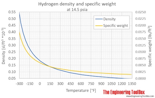

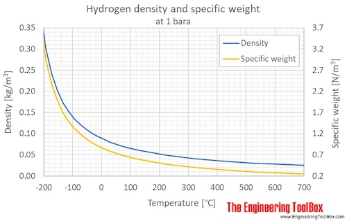

Gas |
20.23 | -252.9 | -423.3 | 0.1 | 1 | 14.5 | 0.6563 | 1.323 | 0.08259 | 2.567 | 13.0 | 0.0826 |
| 40 | -233 | -388 | 0.1 | 1 | 14.5 | 0.3054 | 0.6157 | 0.03844 | 1.195 | 6.04 | 0.0384 | |
| 60 | -213 | -352 | 0.1 | 1 | 14.5 | 0.2013 | 0.4059 | 0.02534 | 0.7876 | 3.98 | 0.0253 | |
| 80 | -193 | -316 | 0.1 | 1 | 14.5 | 0.1505 | 0.3035 | 0.01895 | 0.5889 | 2.98 | 0.0189 | |
| 100 | -173 | -280 | 0.1 | 1 | 14.5 | 0.1203 | 0.2425 | 0.01514 | 0.4705 | 2.38 | 0.0151 | |
| 120 | -153 | -244 | 0.1 | 1 | 14.5 | 0.1002 | 0.2020 | 0.01261 | 0.3919 | 1.98 | 0.0126 | |
| 140 | -133 | -208 | 0.1 | 1 | 14.5 | 0.08586 | 0.1731 | 0.01081 | 0.3359 | 1.70 | 0.0108 | |
| 160 | -113 | -172 | 0.1 | 1 | 14.5 | 0.07510 | 0.1514 | 0.009452 | 0.2938 | 1.48 | 0.00945 | |
| 180 | -93.2 | -136 | 0.1 | 1 | 14.5 | 0.06677 | 0.1346 | 0.008403 | 0.2612 | 1.32 | 0.00840 | |
| 200 | -73.2 | -99.7 | 0.1 | 1 | 14.5 | 0.06007 | 0.1211 | 0.007560 | 0.2350 | 1.19 | 0.00756 | |
| 220 | -53.2 | -63.7 | 0.1 | 1 | 14.5 | 0.05461 | 0.1101 | 0.006873 | 0.2136 | 1.08 | 0.00687 | |
| 240 | -33.2 | -27.7 | 0.1 | 1 | 14.5 | 0.05010 | 0.1010 | 0.006305 | 0.1960 | 0.990 | 0.00631 | |
| 260 | -13.2 | 8.3 | 0.1 | 1 | 14.5 | 0.04623 | 0.09319 | 0.005818 | 0.1808 | 0.914 | 0.00582 | |
| 280 | 6.9 | 44.3 | 0.1 | 1 | 14.5 | 0.04293 | 0.08654 | 0.005403 | 0.1679 | 0.849 | 0.00540 | |
| 300 | 26.9 | 80.3 | 0.1 | 1 | 14.5 | 0.04006 | 0.08077 | 0.005042 | 0.1567 | 0.792 | 0.00504 | |
| 320 | 46.9 | 116 | 0.1 | 1 | 14.5 | 0.03756 | 0.07572 | 0.004727 | 0.1469 | 0.743 | 0.00473 | |
| 340 | 66.9 | 152 | 0.1 | 1 | 14.5 | 0.03535 | 0.07127 | 0.004449 | 0.1383 | 0.699 | 0.00445 | |
| 360 | 86.9 | 188 | 0.1 | 1 | 14.5 | 0.03339 | 0.06731 | 0.004202 | 0.1306 | 0.660 | 0.00420 | |
| 400 | 127 | 260 | 0.1 | 1 | 14.5 | 0.03005 | 0.06058 | 0.003782 | 0.1175 | 0.594 | 0.00378 | |
| 500 | 227 | 440 | 0.1 | 1 | 14.5 | 0.02404 | 0.04847 | 0.003026 | 0.09405 | 0.475 | 0.00303 | |
| 600 | 327 | 620 | 0.1 | 1 | 14.5 | 0.02004 | 0.04040 | 0.002522 | 0.07839 | 0.396 | 0.00252 | |
| 700 | 427 | 800 | 0.1 | 1 | 14.5 | 0.01718 | 0.03463 | 0.002162 | 0.06719 | 0.340 | 0.00216 | |
| 800 | 527 | 980 | 0.1 | 1 | 14.5 | 0.01503 | 0.03030 | 0.001892 | 0.05879 | 0.297 | 0.00189 | |
| 900 | 627 | 1160 | 0.1 | 1 | 14.5 | 0.01336 | 0.02693 | 0.001681 | 0.05225 | 0.264 | 0.00168 | |
| 1000 | 727 | 1340 | 0.1 | 1 | 14.5 | 0.01202 | 0.02424 | 0.001513 | 0.04703 | 0.238 | 0.00151 | |
