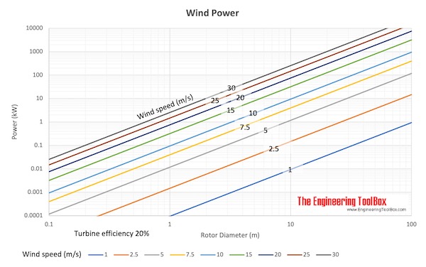

Theoretically power in moving air - or wind - can be calculated
P = ρ A v3 / 2
   = ρ π d2 v3 / 8                                           (1)
P = power (W)
ρ = density of air (kg/m3)
A = wind mill area perpendicular to the wind (m2)
v = wind speed (m/s)
π = 3.14....
d = wind mill diameter (m)
Be aware that the density of air decreases with temperature and altitude and that the major factor in wind power generation is wind speed.
  • 20% increase in wind velocity will increase the power generation with 73%

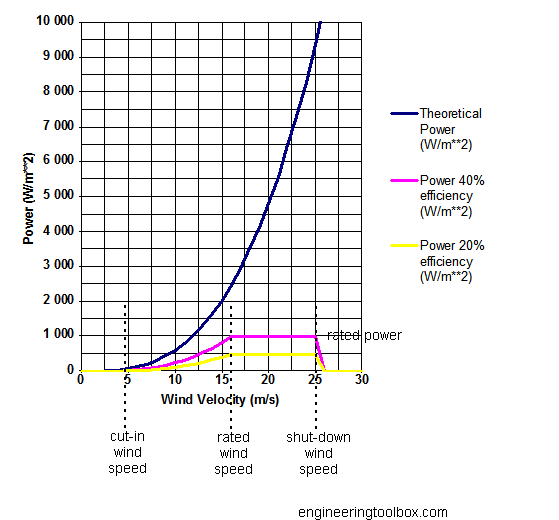

The theoretical and rated wind power generation from a typical windmill is indicated in the "wind speed-power curve" below. Cut-in wind speed, rated wind speed, shut-down wind speed and rated power for windmills with 20% and 40% efficiency.
wind speed power curve

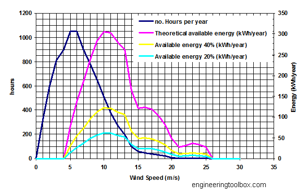

The energy generated over time depends on the wind mill potential power generation (as indicated above) - and how often, or how many hours the wind blows - or more scientifically - the "wind speed frequency distribution" at the actual location.
The total energy generated over a year can be calculated by summarizing the power generation for all velocities (ranging from the actual windmill cut-in speed to the shut-down speed) multiplied with the no. of hours the wind blows at the actual speeds.
A typical wind speed frequency distribution diagram with energy produced at the different velocities is indicated below.
