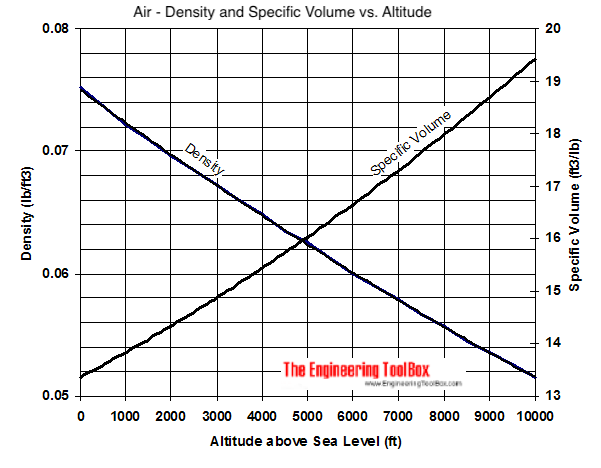

Altitude and Air Density
Air density and specific volume as functions of altitude above sea level can be indicated as in the diagrams below:

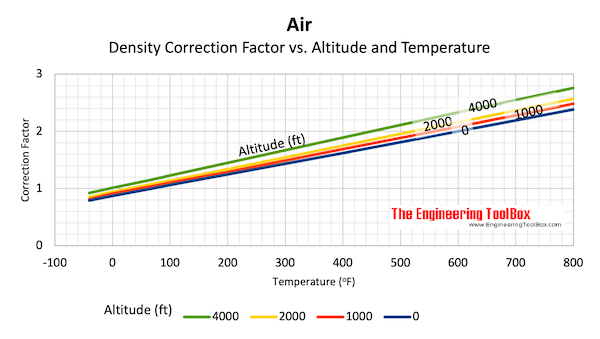

Temperature vs. Elevation Density Correction
The chart above can be used to estimate "temperature vs. elevation density correction factor". The density at a given temperature and elevation can then be calculated as
ρ = ρref / f (1)
ρ = density at the given temperature and elevation (lbm/ft3)
ρref = density reference at elevation 0 ft and temperature 70 oF - (0.075 lbm/ft3)
f = correction factor from the chart above
Example - Density at Elevation 4000 ft and Temperature 300 oF
From the chart above - at elevation 4000 ft and temperature 300 oF the correction factor is approximate 1.7. The density can be calculated as
ρ = (0.075 lbm/ft3) / 1.7
= 0.043 lbm/ft3
