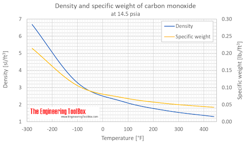

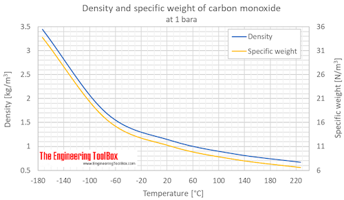

Density and specific weight of carbon monoxide gas at varying temperature and atmospheric pressure, SI and Imperial units:
CO density 1 bara C
CO density 1 bara F

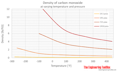

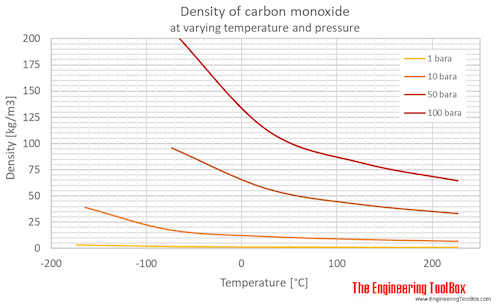

Density of carbon monoxide at varying temperature and pressure, SI and Imperial units:
CO density pressure C
CO density pressure F

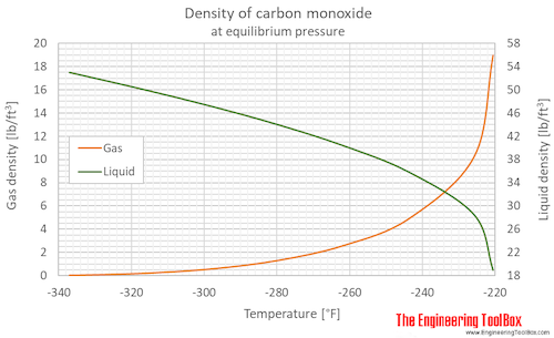

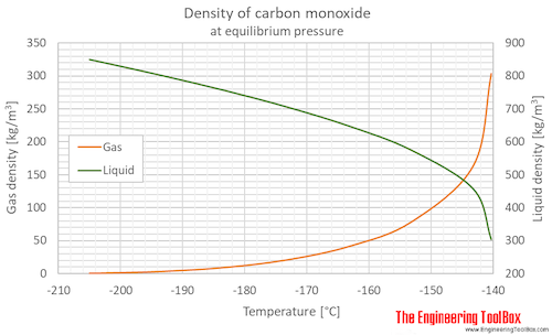

Density of carbon monoxide at varying temperature and equilibrium pressure, SI and Imperial units:
CO density equlibrium C
CO density equlibrium F

State Temperature Pressure Density Specific weight
(K) (°C) (°F) (bara) (psia) (mol/dm3) (g/l),
(kg/m3)
(lb/ft3) (sl/ft3) (N/m3) (lbf/ft3)
Liquid at
equilibrium
68.16 -204.99 -336.98 0.155 2.25 30.33 849.5 53.03 1.648 8331 53.03
70 -203 -334 0.211 3.05 30.06 842.1 52.57 1.634 8258 52.57
80 -193 -316 0.837 12.1 28.57 800.3 49.96 1.553 7848 49.96
90 -183 -298 2.39 34.6 26.97 755.4 47.16 1.466 7408 47.16
100 -173 -280 5.44 79.0 25.18 705.4 44.04 1.369 6918 44.04
110 -163 -262 10.7 155 23.11 647.4 40.42 1.256 6349 40.42
120 -153 -244 18.8 272 20.51 574.6 35.87 1.115 5635 35.87
130 -143 -226 30.7 445 16.29 456.2 28.48 0.8852 4474 28.48
132.86 -140.3 -220.5 34.9 507 10.85 303.9 18.97 0.5897 2980 18.97
Gas at
equilibrium
68.16 -204.99 -336.98 0.155 2.25 0.02771 0.7761 0.04845 0.00151 7.611 0.04845
70 -203 -334 0.211 3.05 0.03667 1.027 0.06411 0.00199 10.07 0.06411
80 -193 -316 0.837 12.1 0.1306 3.658 0.2284 0.00710 35.87 0.2284
90 -183 -298 2.39 34.6 0.3449 9.660 0.6031 0.01874 94.73 0.6031
100 -173 -280 5.44 79.0 0.7569 21.20 1.323 0.04113 207.9 1.323
110 -163 -262 10.7 155 1.490 41.74 2.606 0.08099 409.3 2.606
120 -153 -244 18.8 272 2.812 78.77 4.917 0.1528 772.5 4.917
130 -143 -226 30.7 445 5.884 164.8 10.29 0.3198 1616 10.29
Gas 100 -173 -280 1 14.5 0.1230 3.445 0.2150 0.00668 33.78 0.2150
200 -73.2 -99.7 1 14.5 0.06029 1.689 0.1054 0.00328 16.56 0.1054
300 26.9 80.3 1 14.5 0.04010 1.123 0.07013 0.00218 11.02 0.07013
400 127 260 1 14.5 0.03006 0.8420 0.05257 0.00163 8.258 0.05257
500 227 440 1 14.5 0.02405 0.6735 0.04205 0.00131 6.605 0.04205
Liquid 100 -173 -280 10 145 25.26 707.6 44.17 1.373 6939 44.17
108.96 -164 -264 10 145 23.35 654.0 40.83 1.269 6414 40.83
Gas 108.96 -164 -264 10 145 1.393 39.02 2.436 0.07571 382.7 2.436
200 -73.2 -99.7 10 145 0.6173 17.29 1.079 0.03355 169.6 1.079
300 26.9 80.3 10 145 0.4021 11.26 0.7032 0.02186 110.5 0.7032
400 127 260 10 145 0.3000 8.403 0.5246 0.01630 82.40 0.5246
500 227 440 10 145 0.2396 6.712 0.4190 0.01302 65.82 0.4190
Liquid 100 -173 -280 50 725 25.86 724.5 45.226 1.406 7104 45.23
Supercritical
phase
200 -73.2 -99.7 50 725 3.413 95.60 5.968 0.1855 937.5 5.968
300 26.9 80.3 50 725 2.023 56.67 3.538 0.1100 555.7 3.538
400 127 260 50 725 1.482 41.52 2.592 0.08057 407.2 2.592
500 227 440 50 725 1.179 33.01 2.061 0.06406 323.7 2.061
Liquid 100 -173 -280 100 1450 26.48 741.8 46.307 1.439 7274 46.31
Supercritical
phase
200 -73.2 -99.7 100 1450 7.430 208.1 12.992 0.4038 2041 12.99
300 26.9 80.3 100 1450 4.026 112.8 7.040 0.2188 1106 7.040
400 127 260 100 1450 2.908 81.45 5.085 0.1580 798.8 5.085
500 227 440 100 1450 2.305 64.57 4.031 0.1253 633.2 4.031
