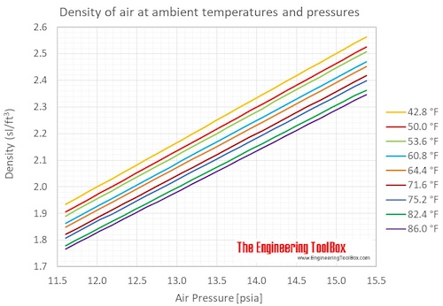

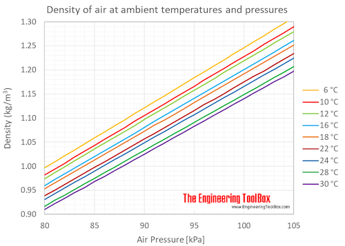

Figures showing air density at ambient pressures (80-105 kPa, 0.8-1.05 bara, 11.6-15.4 psia) and temperatures:

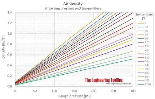

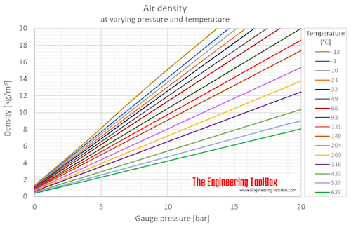

Figures showing air density as function of gauge pressure (0-20 bar, 0-300 psi) at selected temperatures:

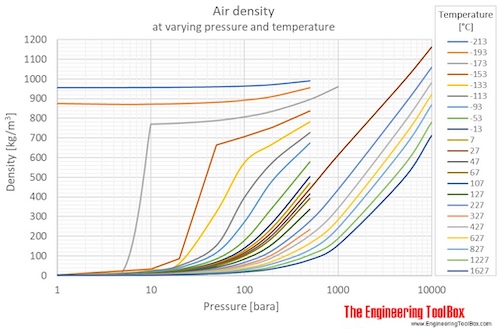

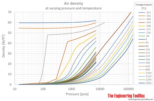

Figures showing air density as function of absolute pressure (1-10 000 bar, 14.5 - 150 000 psia) at selected temperatures:
