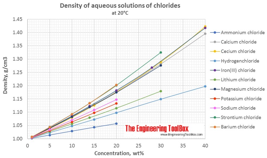

Densities of Aqueous Solutions of Inorganic Chlorides
Changes in density of aqueous solutions with changes in concentration at 20°C. Density of inorganic chlorides in water is plotted as function of wt%, mol/kg water and mol/l solution.

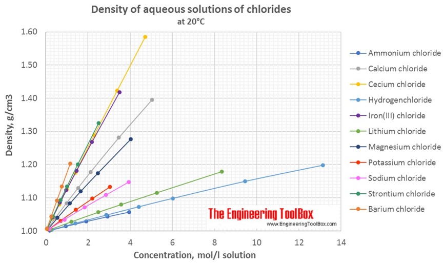

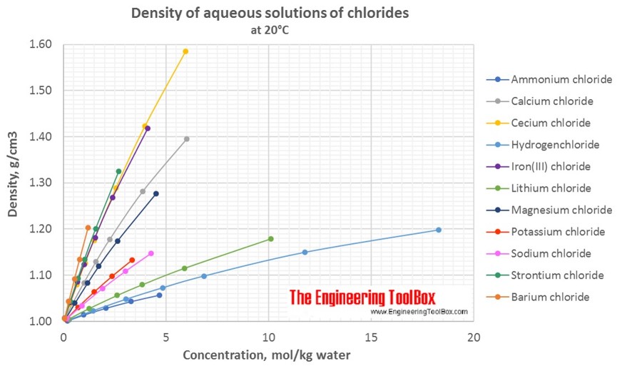

Be aware of the concentration units in the figures:
wt%: Mass of solute/total mass of solution ×100%
mol/kg: Molality = moles of solute/kg of water
mol/liter: Molarity = moles of solute/liter of solution
Values are tabulated below the figures.

Density of aqueous solutions of chlorides
Density of aqueous solutions at 20°C, given as g/cm3:
For full table with Iron, Lithium, Magnesium, Potassium, Sodium and Strontium Chloride - rotate the screen!
Aqueous Solutions of Inorganic Chlorides - Densities
Mass%Ammonium chlorideBarium chlorideCalcium chlorideCecium chlorideHydrogen-chlorideIron(III) chlorideLithium chlorideMagnesium chloridePotassium chlorideSodium chlorideStrontium chloride
1 1.0014 1.007 1.0065 1.0058 1.0031 1.0068 1.0041 1.0062 1.0046 1.0053 1.0071
5 1.0138 1.0434 1.0401 1.0374 1.0228 1.0408 1.0272 1.0394 1.0304 1.034 1.0437
10 1.0286 1.0921 1.0835 1.0798 1.0476 1.0853 1.056 1.0826 1.0633 1.0707 1.0925
20 1.0567 1.2031 1.1775 1.1756 1.098 1.1816 1.115 1.1742 1.1328 1.1478 1.2008
30 1.2816 1.2885 1.1492 1.2679 1.1791 1.2763 1.3248
40 1.3957 1.4226 1.1977 1.4176
50 1.5846

Conversion of the concentration from mass% to mol/kg (moles of solute/kg of water = molality):
Aqueous Solutions of Inorganic Chlorides - Densities - Conversion of the concentration from mass% to mol/kg
1 0.189 0.049 0.091 0.06 0.277 0.062 0.238 0.106 0.135 0.173 0.064
5 0.984 0.253 0.474 0.313 1.444 0.324 1.241 0.553 0.706 0.901 0.332
10 2.077 0.534 1.001 0.66 3.047 0.685 2.621 1.167 1.490 1.901 0.701
20 4.674 1.201 2.2553 1.485 6.857 1.54 5.897 2.626 3.353 4.278 1.577
30 3.862 2.546 11.754 2.398 10.109 4.501 2.703
40 6.007 3.96 18.284 4.11
50 5.94
Molality at 20°C, given as mol/kgwater
Conversion of the concentration from mass% to mol/liter (moles of solute/liter of solution = molarity):
Aqueous Solutions of Inorganic Chlorides - Densities - Conversion of the concentration from mass% to mol/liter
1 0.187 0.048 0.091 0.06 0.275 0.062 0.237 0.106 0.135 0.172 0.064
5 0.948 0.251 0.469 0.308 1.403 0.321 1.211 0.546 0.691 0.885 0.329
10 1.923 0.524 0.976 0.641 2.873 0.669 2.491 1.137 1.426 1.832 0.689
20 3.95 1.156 2.122 1.397 6.023 1.457 5.26 2.467 3.039 3.928 1.515
30 3.464 2.296 9.456 2.189 8.344 4.022 2.507
40 5.03 3.38 13.14 3.496
50 4.706
Molarity at 20°C, given as mol/l solution
