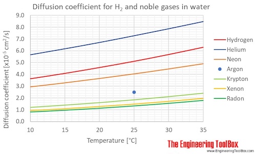

Diffusion coeff noble gases water temp C

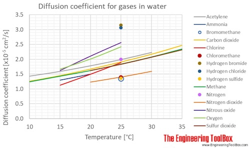

Diffusion coefficients for some common gases in water:
(Gas–liquid diffusion coefficients are difficult to measure, and since the values below are from different sources and different measuring methods, there is some uncertainty about the values)
Gases Solved in Water - Diffusion Coefficients
Gas in water Diffusion coefficient, D, (×10-5cm2/s )
at atmospheric pressure and given temperatures
10 °C 15 °C 20 °C 25 °C 30 °C 35 °C
Name Formula 50 °F 59 °F 68 °F 77 °F 86 °F 95 °F
Acetylene C2H2 1.43 1.59 1.78 1.99 2.23
Ammonia NH3 1.30 1.50
Argon Ar 2.50
Bromomethane CH3Br 1.35
Carbon dioxide CO2 1.26 1.45 1.67 1.91 2.17 2.47
Chlorine Cl2 1.13 1.50 1.89
Chloromethane CH3Cl 1.40
Dichlorofluorumethane CHCl2F 1.80
Helium He 5.67 6.18 6.71 7.28 7.87 8.48
Hydrogen H2 3.62 4.08 4.58 5.11 5.69 6.31
Hydrogen bromide HBr 3.15
Hydrogen chloride HCl 3.07
Hydrogen sulfide H2S 1.36
Krypton Kr 1.20 1.39 1.60 1.84 2.11 2.40
Methane CH4 1.24 1.43 1.62 1.84 2.08 2.35
Neon Ne 2.93 3.27 3.64 4.03 4.45 4.89
Nitrogen N2 2.00
Nitrogen dioxide NO2 1.23 1.40 1.59
Nitrous oxide N2O 1.62 2.11 2.57
Oxygen O2 1.67 2.01 2.42
Radon Rn 0.81 0.96 1.13 1.33 1.55 1.80
Sulfur dioxide SO2 1.62 1.83 2.07 2.32
Xenon Xe 0.93 1.08 1.27 1.47 1.70 1.95
