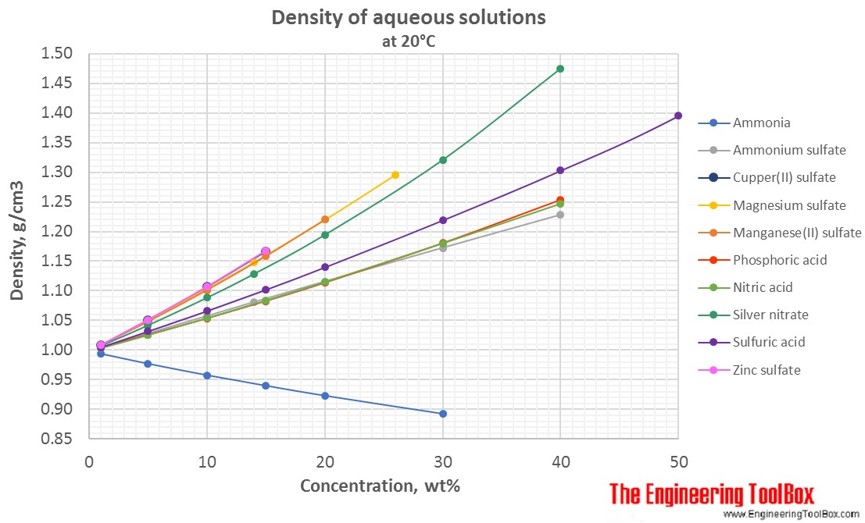

wt%: Mass of solute/total mass of solution ×100%

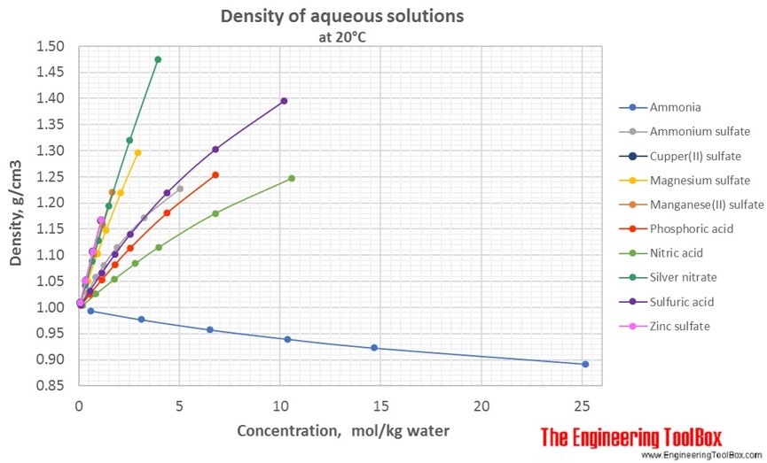

mol/kg: Molality = moles of solute/kg of water

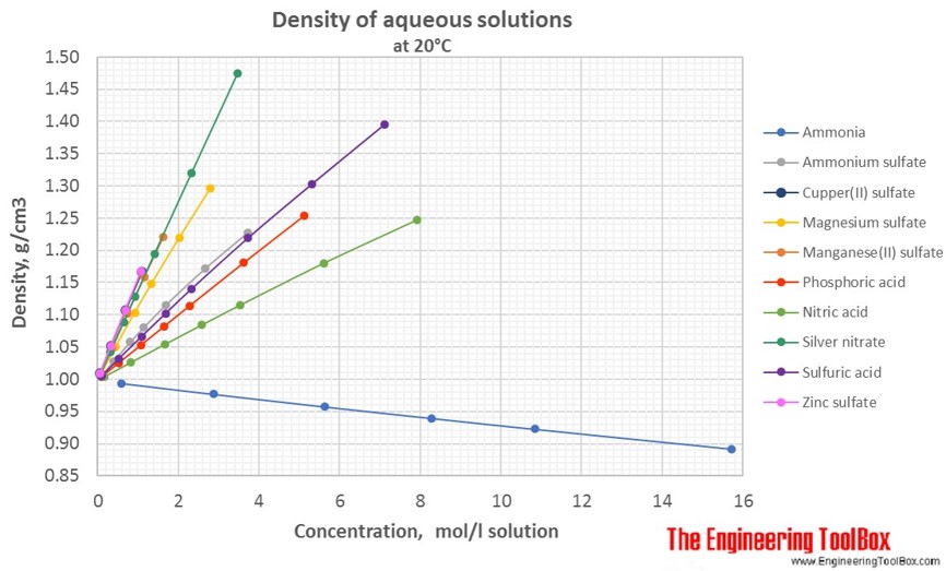

mol/liter: Molarity = moles of solute/liter of solution
Values are tabulated below the figures.

Density of aqueous solutions at 20°C, given as g/cm3:
For full table with Manganese Sulfate, Nitric Acid, Phosphoric Acid, Silver Nitrate, Sulfuric Acid and Zinc Sulfate - rotate the screen!
Aqueous Solutions of some Inorganic Substances - Densities
Mass%AmmoniaAmmonium sulfateCupper(II) sulfateMagnesium sulfateManganese(II) sulfateNitric acidPhosphoric acidSilver nitrateSulfuric acidZinc sulfate
1 0.9938 1.0042 1.0085 1.0084 1.008 1.0037 1.0038 1.007 1.0049 1.0085
5 0.977 1.0279 1.0511 1.0497 1.048 1.0257 1.0254 1.0417 1.0318 1.0511
10 0.9575 1.0574 1.107 1.1034 1.1012 1.0543 1.0531 1.0882 1.0661 1.1071
20 0.9228 1.1154 1.2198 1.2203 1.115 1.1135 1.1942 1.1398
30 0.892 1.1721 1.2961 1.1801 1.1804 1.3204 1.2191
40 1.2277 1.2466 1.2536 1.4743 1.3028
50 1.3952
70 1.6105
100 1.8305

Conversion of the concentration from mass% to mol/kg (moles of solute/kg of water = molality):
Aqueous Solutions of some Inorganic Substances - Densities - Conversion of the concentration from mass% to mol/kg
1 0.593 0.076 0.063 0.084 0.067 0.16 0.103 0.059 0.103 0.063
5 3.09 0.398 0.33 0.437 0.349 0.835 0.537 0.31 0.537 0.326
10 6.524 0.841 0.696 0.923 0.736 1.763 1.134 0.654 1.133 0.688
20 14.679 1.892 2.077 1.656 3.967 2.551 1.472 2.549
30 25.164 3.243 2.919 6.801 4.373 2.523 4.37
40 5.045 10.58 6.803 3.925 6.797
50 10.196
70 23.79
100
Molality at 20°C, given as mol/kg water
Conversion of the concentration from mass% to mol/liter (moles of solute/liter of solution = molarity):
Aqueous Solutions of some Inorganic Substances - Densities - Conversion of the concentration from mass% to mol/liter
1 0.584 0.076 0.063 0.084 0.067 0.159 0.102 0.059 0.102 0.062
5 2.868 0.389 0.329 0.436 0.347 0.814 0.523 0.307 0.526 0.326
10 5.622 0.8 0.694 0.917 0.729 1.673 1.075 0.641 1.087 0.686
20 10.837 1.688 2.027 1.616 3.539 2.273 1.406 2.324
30 15.713 2.661 2.8 5.618 3.614 2.332 3.729
40 3.716 7.913 5.117 3.472 5.313
50 7.113
70 11.494
100 18.663
Molarity at 20°C, given as mol/l solution
