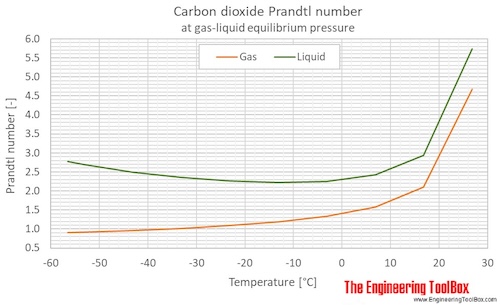

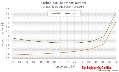

Carbon dioxide Prandtl number at gas-liquid equilibrium pressure, temperature given as °C or °F:
CO2 Prandtl no equilibrium pressure C
CO2 Prandtl no equilibrium pressure F

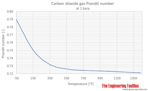

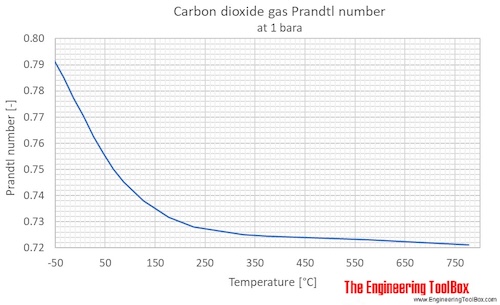

Carbon dioxide Prandtl number at atmospheric pressure, temperature given as °C and °F:
CO2 Prandtl no 1bara C
CO2 Prandtl no 1bara F

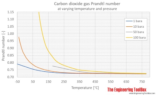

Carbon dioxide Prandtl number at varying temperatures at given constant pressures, SI and Imperial units:
CO2 Prandtl no pressure C
CO2 Prandtl no pressure F
