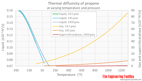

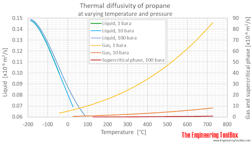

Below, thermal diffusivity of propane at varying temperatures and 1, 10, 50 and 100 bara (14.5, 145, 725 and 1450 psia) are given in figures and tables.
See also other properties of propane at varying temperature and pressure: Density and specific weight, Dynamic and Kinematic Viscosity, Prandtl number, Specific heat (heat capacity), Thermal conductivity, and Thermophysical properties at standard conditions,
as well as thermal diffusivity of air, nitrogen and water .
Thermal diffusivity of propane at 1, 10 and 100 bara (14.5, 145 and 1450 psia), and varying temperature given as °C or °F:
