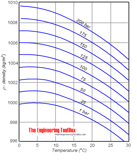

The density of a liquid will change with temperature and pressure. The density of water versus temperature and pressure is indicated below:
Water density vs. temperature and pressure

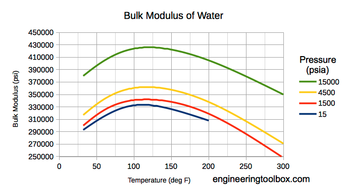

Bulk modulus for water - Imperial Units
Water - bulk modulus - psi

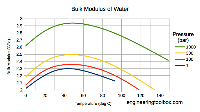

Bulk modulus for Water - SI units
Water - bulk modulus - GPa
