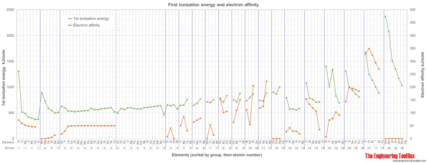

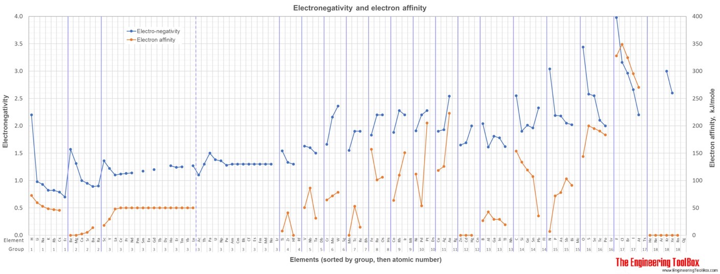

Elements of the Periodic System
The elements of the periodic system with names, symbols, atomic numbers and weights, melting and boiling points, density, electronegativity and electron affinity, and electron configuration.
Figures and tables showing the elements from the periodic table - their name, symbol, atomic number, average atomic weight, state at 273 K, melting and boiling point, density at standard temperature and pressure, electronegativity, electron affinity, electron configuration and first ionisation energy.
Average atomic mass is the same number as molar mass, however, the unit for molar mass is g/mol.
For elements without stable isotops, the mass number for the isotop with the longest half-life is given in parenthesis.
For full table with boiling points, density, electronegativity - rotate the screen!

7) Electron configuration per shell lists the number of electrons in each shell of electrons, starting from the inner shell.
8) 1st ionisation energy is the energy required to remove the most loosely held electron from one mole of gaseous atoms to produce 1 mole of gaseous ions each with a charge of 1+: X(g) --> X+(g) + e- It could also be described as a neutral atom's likelihood of giving away an electron. Ionisation energies are measured in kJ mol-1 (kilojoules per mole). They vary from 380 up to 2372 kJ/mole.
