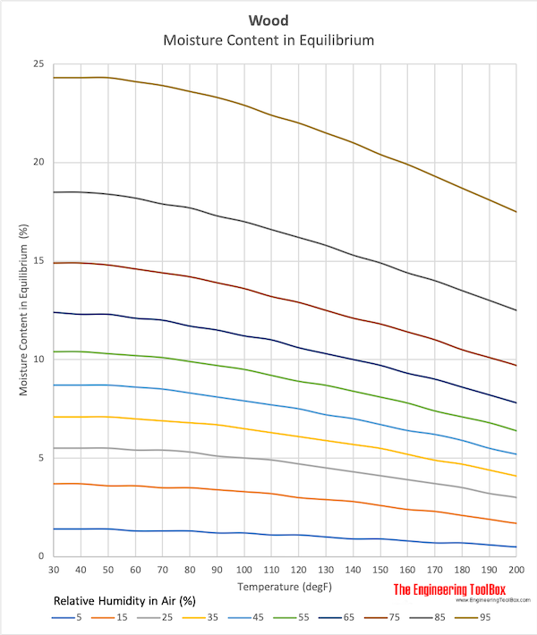

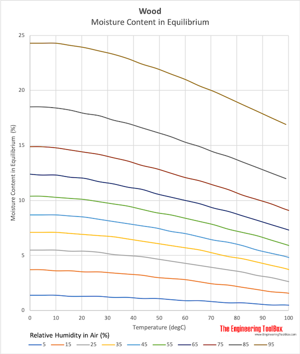

Moisture Content of Wood in Equilibrium with Relative Humidity and Temperature
- in Fahrenheit
- in Celsius
Example - Moisture Content in Wood - Summer vs. Winter
At a given location the typical summer condition inside a house is 25 oC temperature with 65% relative humidity. The typical winter condition in the same house is 18 oC temperature with 15% relative humidity.
From the chart above we can estimate the moisture content in the wood in the house at summer time to be 12%. The moisture content at winter time can be estimated to be 3-4%.
