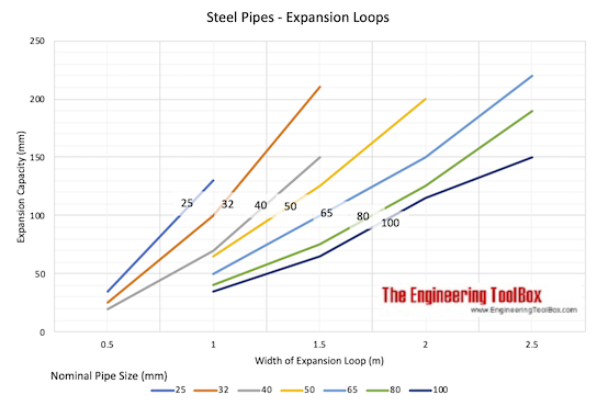

Steel Pipes - Thermal Expansion Loops
Nominal Pipe Size
(mm)
Approximate Expansion Capacity (mm)
Width of Expansion Loop - w - (m)
0.51.01.52.02.5
25 35 130
32 25 100 210
40 20 70 150
50   65 125 200
65   50 100 150 220
80   40 75 125 190
100   35 65 115 150

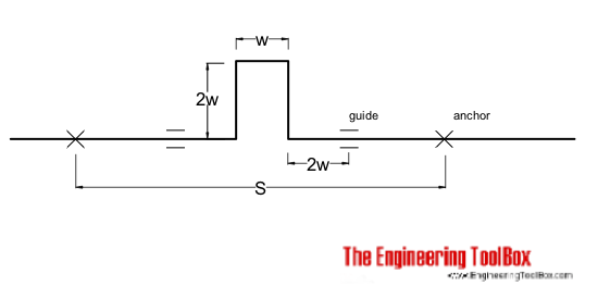

U-Bends Expansion Compensator Calculator
Metric Units
This calculator can be used to calculate required width and height of an U-bends expansions compensator.
Imperial Units
The U-loops calculation is based on equation
w = 0.015 (dl ⋅ D)1/2       (1)
w = width of loop (m)
dl = α ⋅ dt ⋅ S = temperature expansion (mm)
α = temperature expansion coefficient (mm/moC)
dt = temperature change (oC)
S = length of expanding pipe (m)
D = diameter of pipe (mm)
The offset of the loop is 2 w. The length of the loop is 5 w.
Example - Steel Pipe Expansion
A 50 mm steel pipe with length 30 m is heated from 0 oC to 180 oC (typical for steam pipes pressurized to 10 bar).
The temperature expansion coefficient of the steel is 12x10-6 m/mK
The expansion length can be calculated as
 dl = (12x10-6 m/mK) (180 oC - 0 oC) (30 m)
     = 0.0648 m
     = 64.8 mm
The width of the loop can be calculated as
w = 0.015 ((64.8 mm) (50 mm))1/2
    = 0.85 m
The "offset" of the loop (2w) is 1.71 m and the lenght of the loop (5w) is 4.27 m.

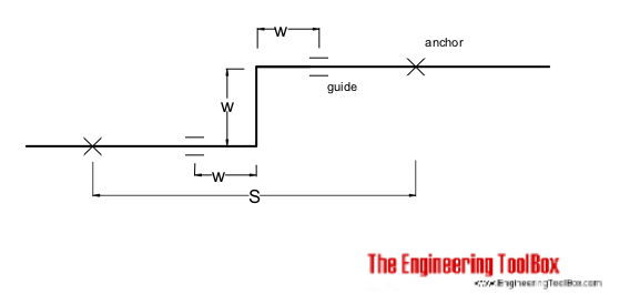

Z-Bends Expansion Compensator Calculator
z-bends expansion pipe line compensator
Metric Units
This calculator can be used to calculate required offset in a Z-bends expansions compensator.
Imperial Units

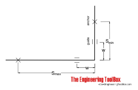

L-Bends Expansion Compensator Calculator
l-bends expansion pipe line compensator
Metric Units
Imperial Units
The L-loop calculation is based on equation
L = 0.063 (dl ⋅ D)1/2       (2)
