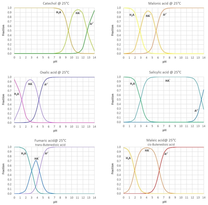

Below the table, figures showing the fractions of the different acid forms in aqueous solutions at varying pH are given for some common diprotic organic acids (values calculated from the tabulated pKa s).

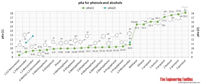

Phenols, Alcohols and Carboxylic Acids - pKa Values
| Group | IUPAC name | Common name | #C | #H | #O | pKa1 | pKa2 | Molweight g/mol | Melting temp °C | Boiling temp °C | Density @20°C5* g/ml |

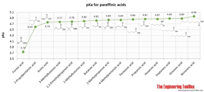

| Alkanoic acid |
Formic acid |
Methanoic acid |
1 |
2 |
2 |
3.74 |
46.0 |
8 |
101 |

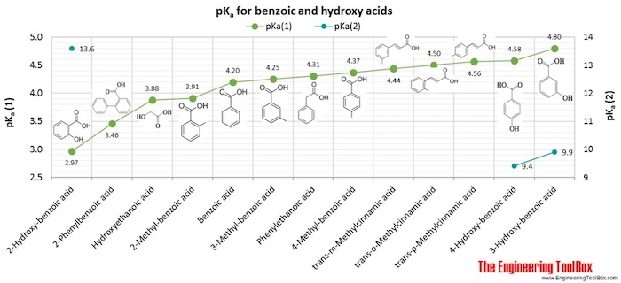

| Benzoic acid |
Benzoic acid |
Benzenecarboxylic acid |
7 |
6 |
2 |
4.20 |
122.1 |
122 |
249 |
1.2663* |
| Benzoic acid |
2-Methyl-benzoic acid |
o-Toluic acid |
8 |
8 |
2 |
3.91 |
136.1 |
107 |
258 |
1.0624* |

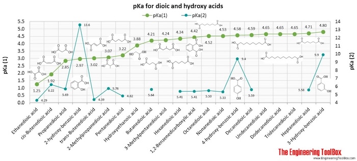

| Dioic acid |
Ethanedioic acid |
Oxalic acid |
2 |
2 |
4 |
1.25 |
4.29 |
90.0 |
d 190 |
s 157 |
1.93* |
| Dioic acid |
Propanedioic acid |
Malonic acid |
3 |
4 |
4 |
2.85 |
5.69 |
104.1 |
136 |
d 140 |
1.6193* |

The figure below shows the fractions of the different acid forms (H2A, HA-and A2- for twoprotic acids) in aqueous solutions at varying pH :
