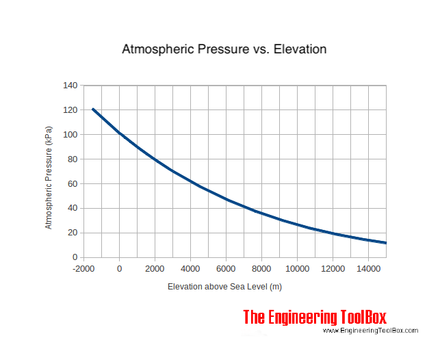

Air pressure above sea level can be calculated as
p = 101325 (1 - 2.25577 10-5 h)5.25588                           (1)
101325 = normal temperature and pressure at sea level (Pa)
p = air pressure (Pa)
h = altitude above sea level (m)
Example - Air pressure at Elevation 10000 m
The air pressure at altitude 10000 m can be calculated as
p = 101325 (1 - 2.25577 10-5 (10000 m))5.25588
  = 26436 Pa
  = 26.4 kPa
Air - altitude in meters and atmospheric air pressure in kPa
The table below indicates air pressure at elevations below and above sea level.
