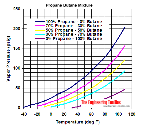

Propane Butane Mix Vapor Diagram - psig
Propane butane mix - vapor diagram - imperial units - psig

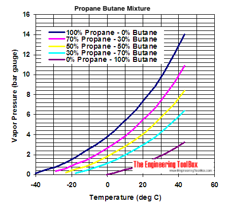

Propane Butane Mix Vapor Diagram - bar
Propane butane mix - vapor diagram - metric units - bar
