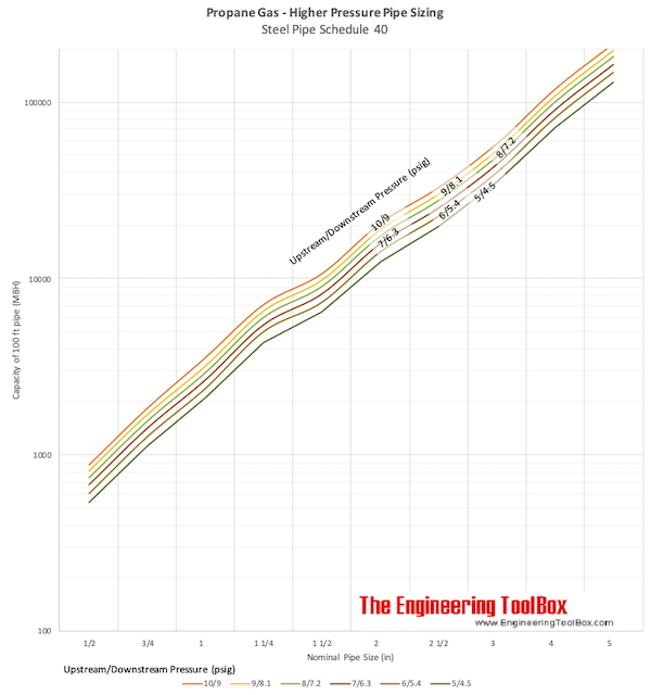

Propane Gas Pipe Capacity Diagram - 10% Pressure Drop
Propane gas pipe sizing diagram - psi
