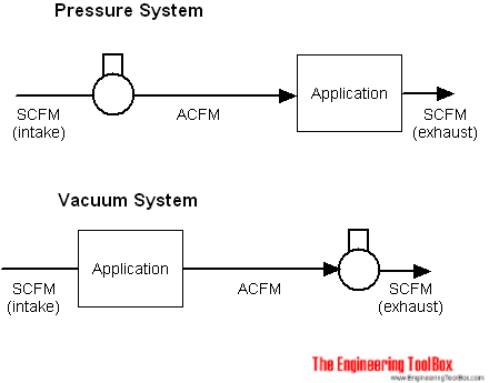

compressor vacuum systems scfm acfm icfm
ACFM - Actual Cubic Feet per Minute
Real life "actual conditions" are seldom "standard conditions". When
  • pressure is applied a volume of air - it gets smaller
  • vacuum is applied to a volume of air - it expands
The actual air volume flow is often termed ACFM - Actual Cubic Feet per Minute.
The Actual Cubic Feet per Minute - ACFM - depends on the
  • pressure
  • temperature
  • humidity
of the actual air.
