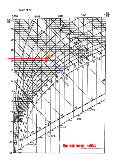

Example - How to use the Mollier Chart
The state of air with dry bulb temperature 21 oC and relative humidity 50% is indicated in the Moliier chart below:
From the Mollier chart the enthalpy of the moist air is approximately 40 kJ/kg . The wet bulb temperature is approximately 14.5 oC . The specific humidity is approximately 0.0076 kg/kg .
