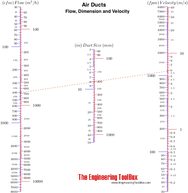

Air Ducts - Velocity Diagram
The chart below can be used to estimate velocities in air ducts.
The default values are for air flow 400 cfm (680 m3/h) , duct size 8 in (200 mm) and velocity 1150 fpm (5.8 m/s) .
Download and print Air Ducts - Velocity Diagram!
