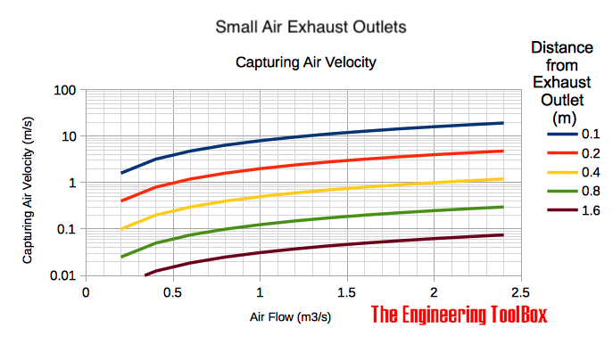

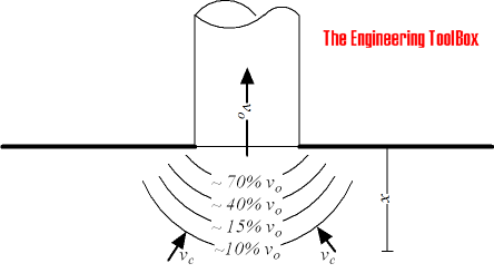

The capturing air velocity in a distance x from an exhaust outlet can be calculated as
vc = q / (4 π x2)
    = vo A / (12 x2)
    = vo π d2 / (48 x2)                                    (1)
q = air volume flow (m3/s, ft3/s)
A = duct area (m2, ft2)
vc = capture air velocity in distance x from exhaust outlet (m/s, ft/s)
vo = air velocity in the exhaust outlet opening (m/s, ft/s)
d = diameter of exhaust outlet (m, ft)
x = distance from exhaust outlet (m, ft)
Note! According to line one of the equation (1) - the capture velocity is not dependent on the size of duct. This equation can only be used for exhaust outlets with relatively small diameters.

Example - Capturing air velocity for a  smaller exhaust outlet
Capturing air velocity in distance 250 mm from a 250 mm duct with internal air velocity of 3 m/s can be calculated as
vc = (3 m/s) π (0.250 m)2/ (48 (0.250 m)2)
        = 0.2 m/s
Note! The air velocity in distance one diameter from the duct outlet - is less than 10% of the duct air velocity.

Exhaust Outlets in Walls or with Flanges
Ventilation - wall mounted exhaust hood
If the exhaust outlet is in a wall or with a flange the evacuation efficiency is improved and can be expressed as
vc = 1.33 vo A / (A + 10 x2)
    = 1.33 q / (A + 10 x2)                           (3)
The calculator above can be used if volume is multiplied with 1.33. Use of exhaust hoods improves the evacuation efficiency further.
