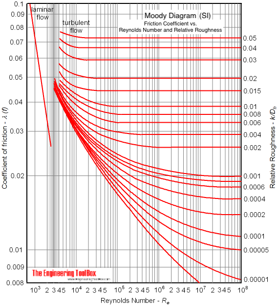

The friction coefficient can also be estimated with the Moody diagram (SI based):
moody diagram SI
Download and print Moody Diagram

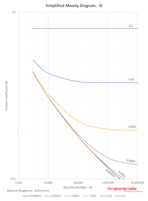

Simplified Moody Diagram - SI
Moody diagram SI - simplified
Download and print simplified Moody Diagram
