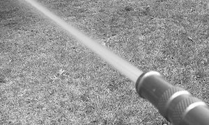

Example - Propulsive Force
garden hose jet flow
Water flows through a garden hose with diameter 15 mm . The water pressure just before the outlet is 4×105 Pa (abs) and the atmospheric pressure is 1×105 Pa (abs).
The outlet area of the hose can be calculated as
A = π ((15 mm) (0.001 m/mm) / 2)2
= 1.77 10 -4 (m2)
The propulsive force can be calculated as
F = 2 ( 1.77×10-4 m2) (( 4×105 Pa) - ( 1×105 Pa))
= 106 N

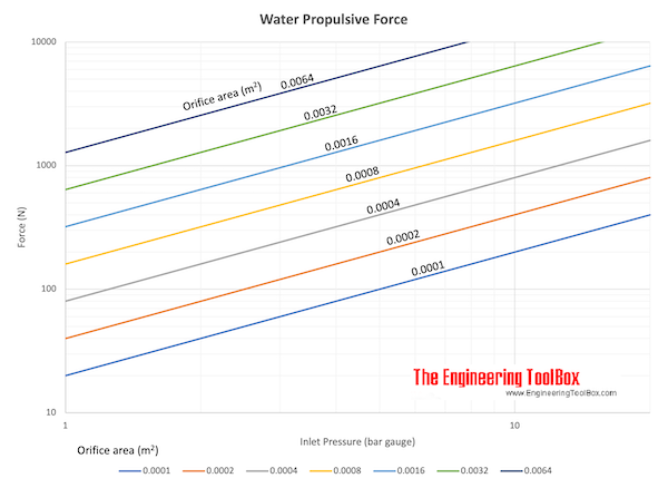

Water jet propulsion
