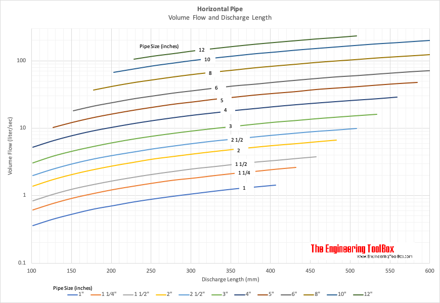

Horizontal pipes - discharge length liter per second

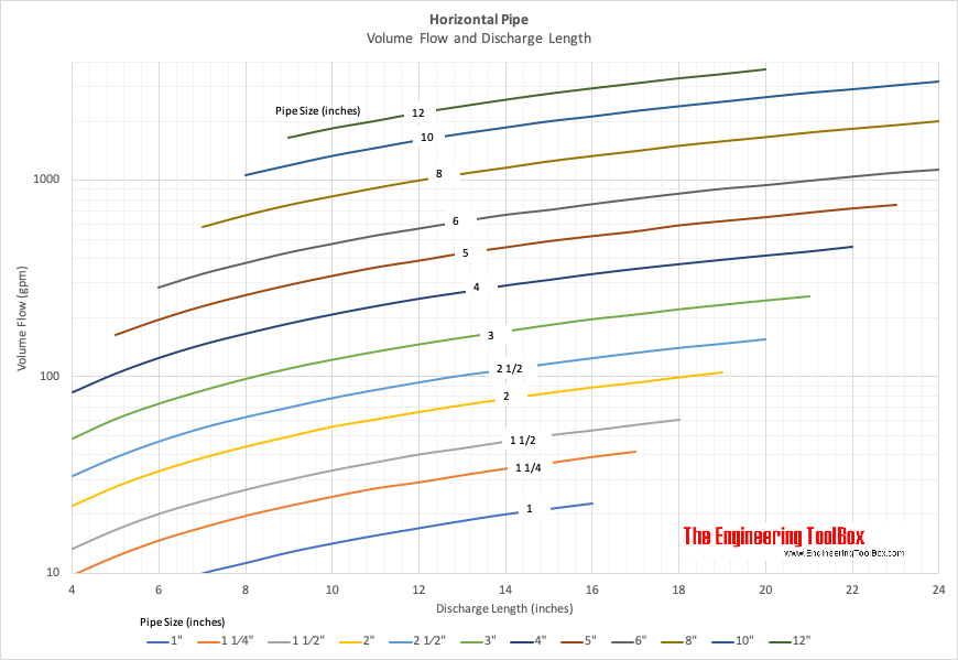

Example - Horizontal Pipe and Length of Water Discharge
If 100 gpm water is discharged from a 2 1/2" horizontal pipe
- the discharge length can be estimated from the chart above to approximately 13 inches.
Example - Estimating Volume Flow with Discharge Length

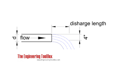

The volume flow  from a pipe can be estimated by measuring the horizontal length of the discharging flow.
If the discharge length from a 2 1/2" horizontal pipe is measured to 13 inches
- the volume flow discharged can be estimated to approximately 100 gpm.
