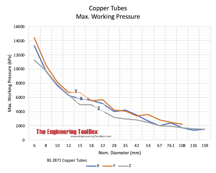

BS 2871 Copper Tubes Table X, Y and Z - Working Pressures vs. Size
Working pressures of metric sized copper tubes according the BS (British Standard) 2871.

For full table with Table Z - rotate the screen!

6 6 0.6 13.3 0.8 14.4 0.5 11.3
8 8 0.6 9.7 0.8 10.5 0.5 9.8
10 10 0.6 7.7 0.8 8.2 0.5 7.8
12 12 0.6 6.3 0.8 6.7 0.5 6.4
15 15 0.7 5.8 1 6.7 0.5 5
18 18 0.8 5.6 1 5.5 0.6 5
22 22 0.9 5.1 1.2 5.7 0.6 4.1
28 28 0.9 4 1.2 4.2 0.6 3.2
35 35 1.2 4.2 1.5 4.1 0.7 3
42 42 1.2 3.5 1.5 3.4 0.8 2.8
54 54 1.2 2.7 2 3.6 0.9 2.5
67 67 1.2 2 2 2.8 1 2
76.1 76.2 1.5 2.4 2 2.5 1.2 1.9
108 108.1 1.5 1.7 2.5 2.2 1.2 1.7
133 133.4 1.5 1.4 1.5 1.6
159 159.4 2 1.5 1.5 1.5
  • 1 N/mm2 = 106 Pa = 1 MPa = 10 bar = 1.020×105 kp/m2 = 102.0 m H2O = 9.869 atm = 145.0 psi (lbf/in2)
