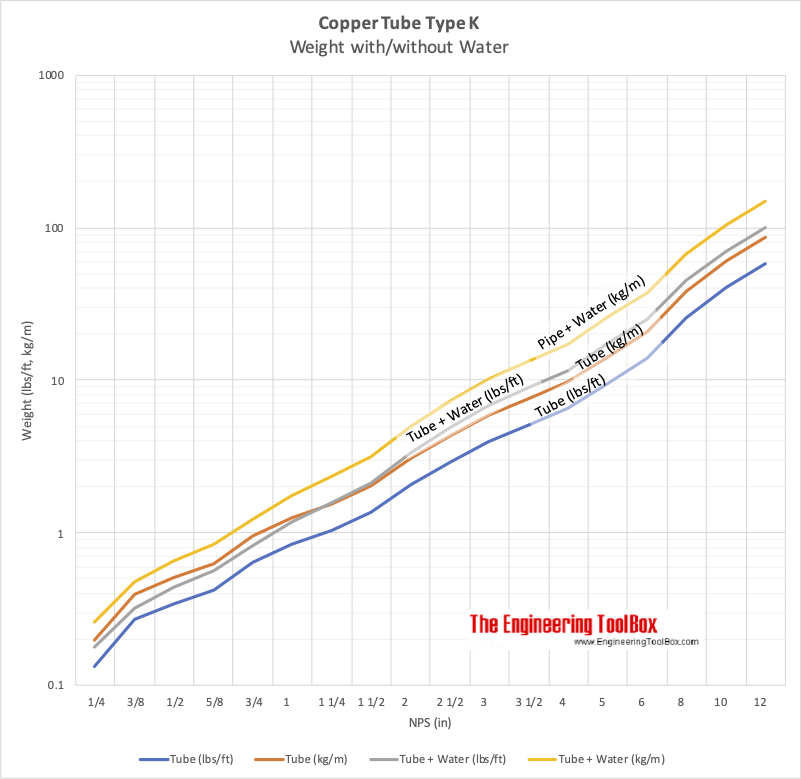

Copper tube type K - weight with or without water
