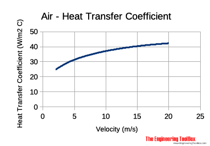

Convective Heat Transfer Coefficient for Air
The convective heat transfer coefficient for air flow can be approximated to
hc = 10.45 - v + 10 v1/2                                     (2)
v = relative speed between object surface and air (m/s)
Note! - this is an empirical equation and can be used for velocities 2 to 20 m/s.
Air - heat transfer coefficient

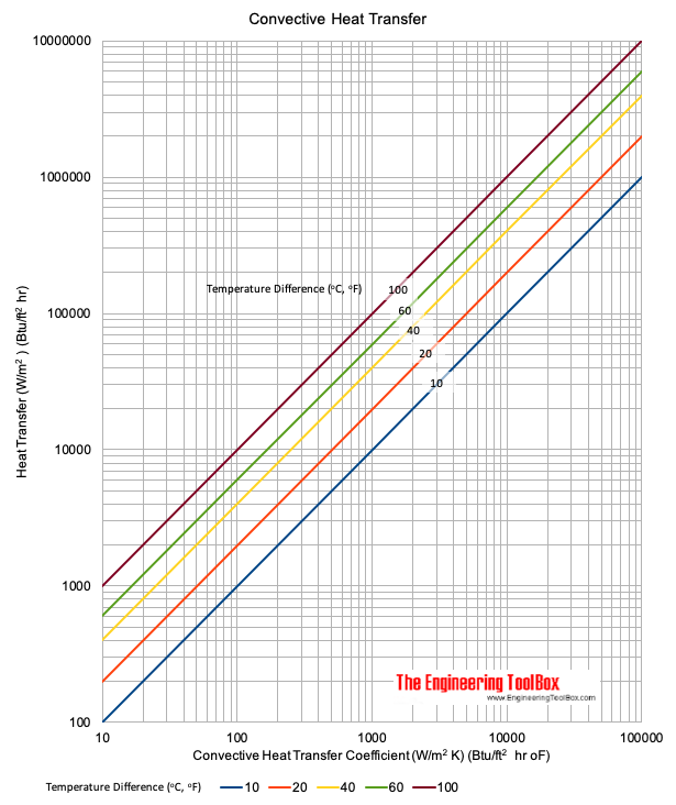

Convective Heat Transfer Chart
Convective heat transfer chart
