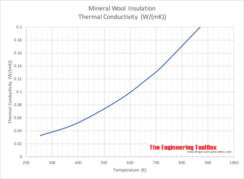

Mineral wool thermal conductivity vs. temperature are indicated in the charts below:
Mineral wool - Thermal Conductivity - Metric Units

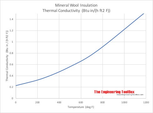

Mineral wool - Thermal Conductivity - Imperial  Units
  • T (oC) = 5/9 (T (oF) - 32)
