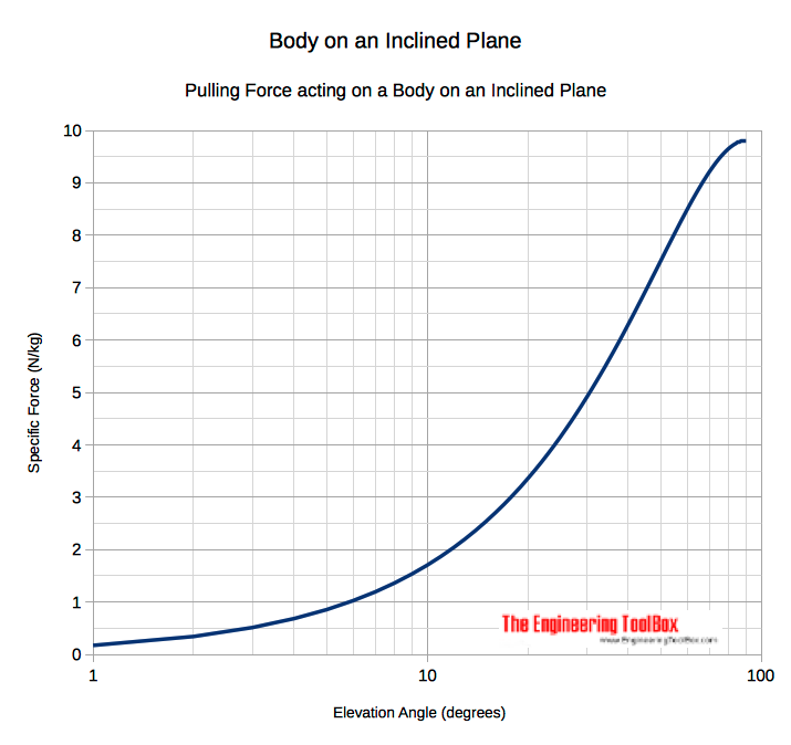

Required forces to move bodies up inclined planes.
Inclined plane - force to pull a body
If we neglect friction between the body and the plane - the force required to move the body up an inclined plane can be calculated as
Fp = W h / l
= W sin(α)
= m ag sin(α)                          (1)
Fp = pulling force (N, lbf)
W = m ag
    =  gravity force - or weight of body (N, lbf)
h = elevation (m, ft)
l = length (m, ft)
α = elevation angle (degrees) (degrees vs. gradient vs. slopes)
m = mass of body (kg, slugs)
ag = acceleration of gravity (9.81 m/s2, 32.174 ft/s2)
By adding friction - (1) can be modified to
Fp = W (sin(α) + μ cos(α))
= m ag (sin(α) + μ cos(α))                          (2)
μ = friction coefficient
Example - Pulling Force on Inclined Plane
A body with mass 1000 kg is located on a 10 degrees inclined plane. The pulling force without friction can be calculated as
Fp = (1000 kg) (9.81 m/s2) sin(10°)
     = 1703 N
     = 1.7 kN
Inclined plane - force acting on a body - diagram
