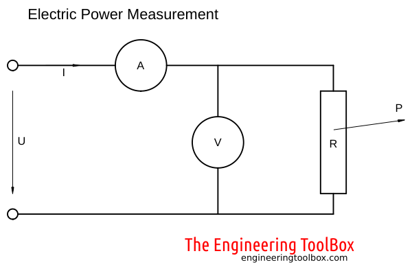

Measure electric power with an ammeter and a voltmeter.
Electric power in a circuit can be measured with an ammeter (amperemeter) and a voltmeter.
electric power measurenet with ammeter and voltmeter
The power can be calculated as
P = U I
   = R I2                  (1)
P = electric power (W, watts)
U = voltage (V, volt)
I = current (A, ampere)
R = resistance (Ω, ohm)
Example - Power consumption of a circuit with an electric heater
The current in a 230 V household circuit with an electric heater is measured with an ammeter to 8 A. The power consumption can be calculated as
P = (230 V) (8 A)
   = 1840 W
