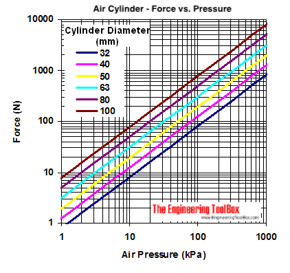

SI-units
Pneumatic air cylinder - acting force vs. pressure diagram - kPa

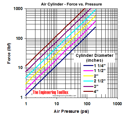

Imperial Units
Pneumatic air cylinder - acting force vs. pressure diagram - psi
