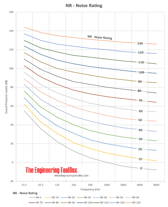

Noise Rating Curves
Maximum Sound Pressure Level (dB)
Noise Rating
- NR -
Curve
Octave band mid-frequency (Hz)
31.562.51252505001000200040008000
NR 0 55 36 22 12 5 0 -4 -6 -8
NR 10 62 43 31 21 15 10 7 4 2
NR 20 69 51 39 31 24 20 17 14 13
NR 30 76 59 48 40 34 30 27 25 23
NR 40 83 67 57 49 44 40 37 35 33
NR 50 89 75 66 59 54 50 47 45 44
NR 60 96 83 74 68 63 60 57 55 54
NR 70 103 91 83 77 73 70 68 66 64
NR 80 110 99 92 86 83 80 78 76 74
NR 90 117 107 100 96 93 90 88 86 85
NR 100 124 115 109 105 102 100 98 96 95
NR 110 130 122 118 114 112 110 108 107 105
NR 120 137 130 126 124 122 120 118 117 116
NR 130 144 138 135 133 131 130 128 127 126
NR - Noise Rating Diagram

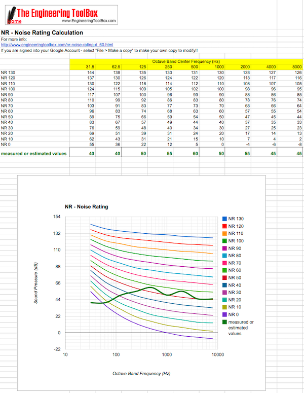

Example - Estimating NR - Noise Rating
The sound pressure levels for different NR frequencies are measured to
  • 31.5 Hz : 40 dB
  • 62.5 Hz : 40 dB
  • 125 Hz : 50 dB
  • 250 Hz : 55 dB
  • 500 Hz : 60 dB
  • 1000 Hz : 50 dB
  • 2000 Hz : 55 dB
  • 4000 Hz : 45 dB
  • 8000 Hz : 45 dB
The Noise Rating - NR -  can be estimated as indicated in the spreadsheet diagram below to approximately
NR = 58 dB
Open the NR - Noise Rating example in your browser!
You can save and modify your own copy of the example above if you are signed into your Google Account.
