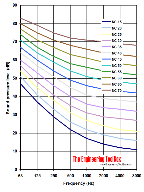

Noise Criterion - NC - level is a standard describing relative loudness of a space with a range of frequencies
Sponsored Links
Noise Criterion - NC - were established in the U.S. for rating indoor noise like noise from air-conditioning equipment and similar. In Europe it is common to use the alternative Noise Rating Curve - NR.
The method is based on a measurement of sound pressures levels and a set of sound pressure criteria curves ranging frequencies from 63 to 8000 Hz - and a tangent rating procedure. The criteria curves defines the limits of the octave band spectra that must not be exceeded to meet the occupants acceptance in the actual spaces.
The NC rating can be determined by plotting the measured sound pressure at each octave band. The noise spectrum is specified as having a NC rating same as the lowest NC curve which is not exceeded by the spectrum.
NC - noise criteria diagram
Noise CriterionOctave Band Center Frequency (Hz)
631252505001000200040008000
Sound Pressure Levels (dB)

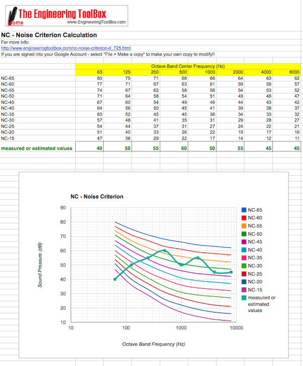

Example - Estimate Rated Noise by using the Noise Criterion
Sound pressures levels are measured for different frequencies as:
  • 62.5 Hz : 40 dB
  • 125 Hz : 50 dB
  • 250 Hz : 55 dB
  • 500 Hz : 60 dB
  • 1000 Hz : 50 dB
  • 2000 Hz : 55 dB
  • 4000 Hz : 45 dB
  • 8000 Hz : 45 dB
The Noise Criterion can be estimated to
NC = 57 dB
as indicated in the spreadsheet diagram below.
NC - Noise Criterion - Interactive Spreadsheet
You can save and modify your own copy (in Google Docs or as a Excel spreadsheet) of the example below.
NC - noise criterion exampleNCB Curves
