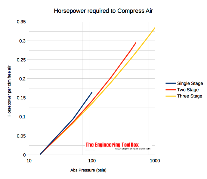

Theoretical horsepower required to compress one cubic foot of free air (atmospheric pressure) for single-staged, two-staged and three-staged compressors are indicated in the diagram below. In general - plus 15-20%  friction.
horsepower required to compress air

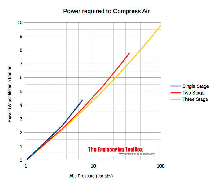

power watts required to compress air - pressure bar
The power required for adiabatic (process without transfer of heat) compression of air can be expressed as
HP = [144 N P1 V k / (33000 (k - 1))] [(P2 / P1)(k - 1)/N k - 1]                                (1)
HP = horsepower
N = number of compression stages
k = 1.41 = adiabatic expansion coefficient
P1 = absolute initial atmospheric pressure (psi) (14.7 psi at sea level)
P2 = absolute final pressure after compression (psi)
V = volume flow of compressed air at atmospheric pressure (cfm, ft3/min)
  • adiabatic compression (or expansion) takes place without transmission of heat
