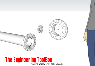

Insert flanges to your Sketchup model with the Engineering ToolBox Sketchup Extension
