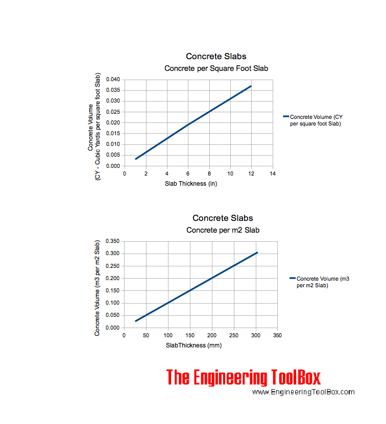

Required concrete is in general calculated in cubic yards (cy).
v =  0.0031 l w t                               (1)
v = required concrete - (cy, cu. yards)
l = slab length (ft)
w = slab width (ft)
t = slab depth (in)
  • 1 cubic yard = 27 cubic feet
  • 1 ft = 12 in
Slab Concrete Volume

Concrete required for concrete slabs can be estimated below:
 estimating concrete slabs
