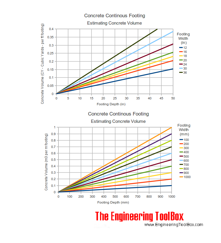

  •  1 cy per linear foot (y3/ft) = 2.5 m3/m
Concrete footing - concrete volume diagram
