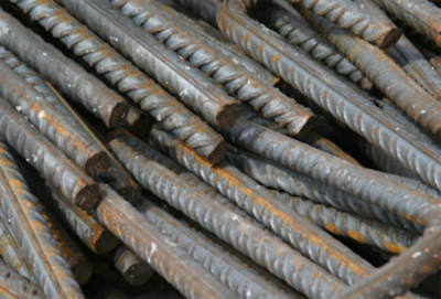

Rebar - Metric Reinforcing Bar
Reinforcing bar - European metric dimensions.
Reinforcing bar- re-bar - metric units
Rebars - Metric Reinforcing Bars
Bar NumberMass
(kg/m)
Nominal Diameter
(mm)
Cross Sectional Area
(mm2)
10M 0.785 11.3 100
15M 1.570 16.0 200
20M 2.355 19.5 300
25M 3.925 25.2 500
30M 5.495 29.9 700
35M 7.850 35.7 1000
45M 11.775 43.7 1500
55M 19.625 56.4 2500
