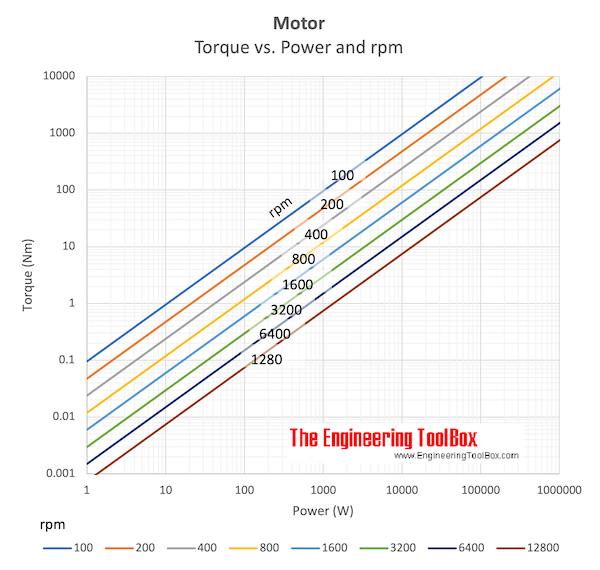

Torque Calculator
P - power (W)
nm - rotations (rpm)
Download and print Motor - Torque vs. Power and rpm chart
